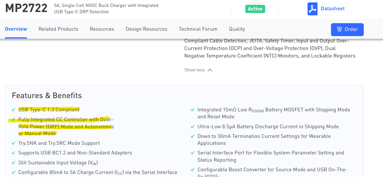

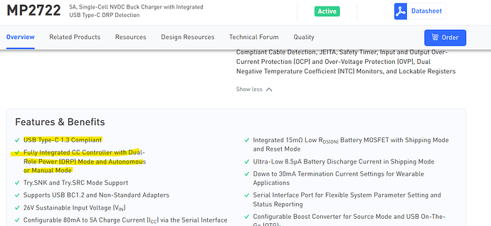

I’m worried I’m not understanding the data sheets correctly. Do these two lines not mean that the MP2722 is able to negotiate Proper PD levels over a USBC connection?
I understand if it may be limited in its voltage range so that it only supports up to 9V (for example), but those are still higher voltages/currents than the USB2 5V 0.5A-1.5A.
Hello asaf.pipman,
This does not have PD negotiation like I said. The following does a good job explaining this USB Type-C Charging Connectors: Design, Optimization, and Interoperability | Article | MPS. I think the main portion being that PD requires a PD controller and the MP2722 datasheet does not call it out.
