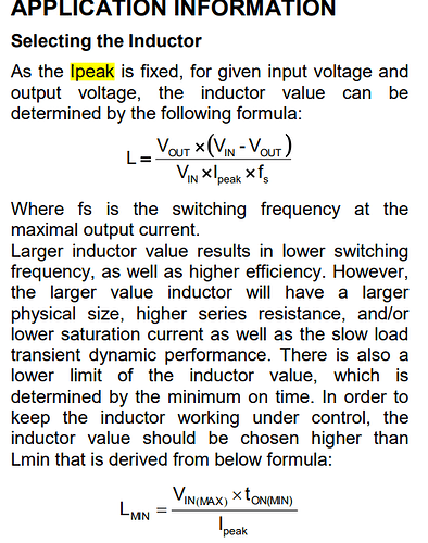

We refered your application diagram in datasheet & implemented our design.
Please find the schematics details below.
Our Vin(max)= 18V, Vin(min)=10.5, Vin(nom)=13.8, Vout=3.3V, Load current(Ipeak) is 20mA, recommended inductor value is 33uH. Kindly review it and let us know
any feedback on the same.
