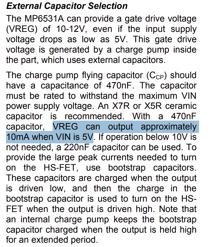

I am planning to use the VREG voltage generated at pin 4 of the MPS6531A.
However, the datasheet does not appear to specify the allowable output current for this supply. Could you please let me know how much current (in amperes) can be drawn from the VREG output? If available, please provide both continuous and peak current ratings, as well as any recommended operating limits or thermal considerations.
Best,
WY
Hi WY,

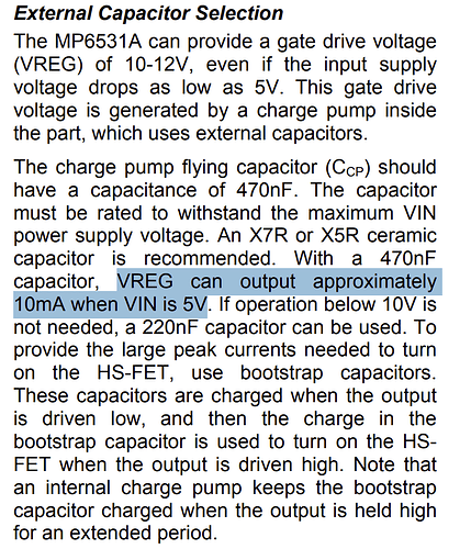

10mA is the output current the pin is capable of.
Best,
Tyler
