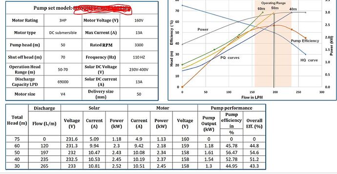

Hello team ,
I have attached the motor specifications which is used in solar water pump applications
which is shared by customer .we are planiing to develop a motor driver controller for the same, from the image please can you help us to identify what type of motor it is .even though it is mentioned DC submersible motor we are getting confused whtether it is BLDC or PMSM -please confirm it
Based on the type of motor please suggest a part to drive the above motor and all the IC which is required since we have observed MPS parts are more cheaper comparted to others we are interested in using the MPS parts
Hello,
Most BLDC motors typically have trapezoidal back-EMF and work well with 6-step communication whereas PMSM motors have sinusoidal back-EMF and are used with FOC.
Based on the specs here, this is most likely a PMSM with FOC. Is there a reason as to why the model number is blocked off here? Any more info you can provide?
