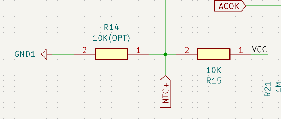

But you need to tell the IC that the temperature is good, otherwise it wont charge, just put a optional resistor and pads for the NTC if you ever need it.
That´s how i do on MP2759. I can populate either the 10k(OPT) resistor or add the NTC.
Just look at the datasheet for the value, it´s probably 10k but better to check, it´s the same resistance as the NTC.
