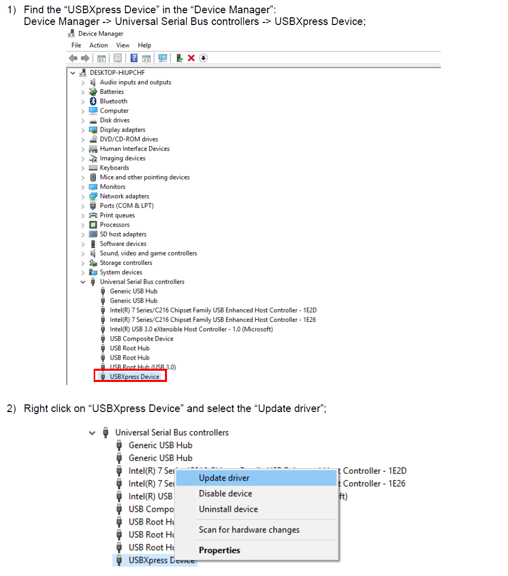

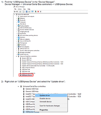

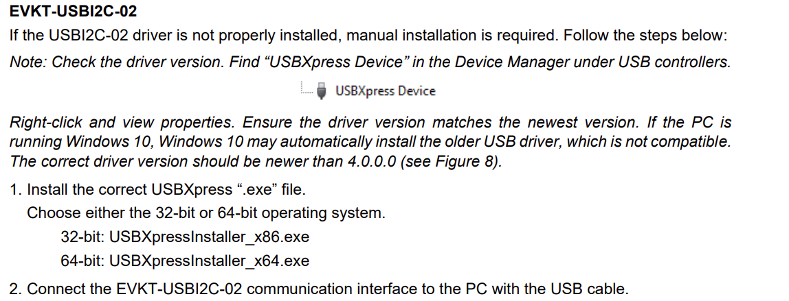

Sorry to hear that you are facing issues with the I2C dongle. The driver installer file must be USBXpressInstaller.
For troubleshooting, I would recommend the following steps:
Kindly update the driver, if the issue still persists
