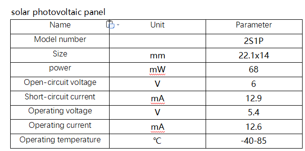

First, the solar panel has an open-circuit voltage of 6V and a short-circuit current of 12.9mA. For detailed parameters, please refer to the attachment.

One question, I see that the model number calls for 2S1P, which corresponds to 2 series cells, however the voltage seems to reflect 1 cell?

the battery is 1 cell 4.2V LI-ion,but the solar panel is 2s1p,the model number calls for 2S1P is for solar panel just.
