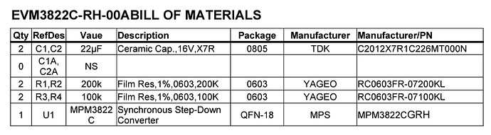

Can anyone recommend specific 0805 ceramic capacitors (i.e. manufacturer part numbers) that work well with the MPM3822? It’s is difficult to find the specs (ESR, RMS current rating) on commodity capacitors. We are using a single X5R 22 uF ceramic cap each on input and output. Load current is < 1A. We have 2 independent regulators in our application (+3.3V → +1.1V, +5V → +3.3V). The MPM3822 was chosen as a replacement for an Enpirion regulator which was discontinued.
I downloaded the MPM3822 evaluation board schematics and layout, but no part numbers were listed there.

Kindly refer to the EVB datasheet: EVM3822C-RH-00A and on page 3 you will find the BOM.
