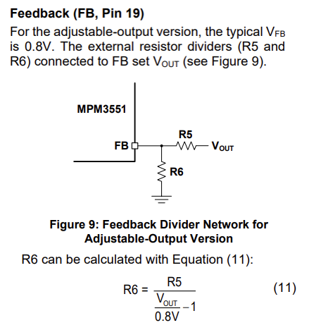

Is there any reason why I cannot set the output voltage to 6V by changing the feedback resistors? The datasheet does not mention how to select the feedback resistors to set the output voltage and only has the two application circuits for 3.3V and 5V.

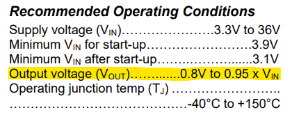

Recommended operation of the MPM3551 is Vout,max = 0.95 * Vin .
With the adjustable output configuration (implementing an external resistor divider to the FB pin), you can calculate the resistor divider values. Please refer to Equation 11 in the datasheet on Page 28.
You may use R5 = 100kOhm as shown in other datasheet typical application circuits.
