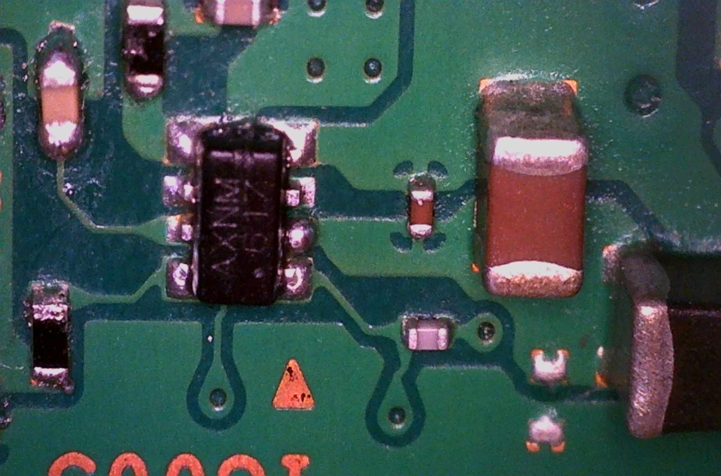

Hello! Please tell me which model is marked as AXNM
Hello,
Are you able to provide any more information like an image perhaps or a package type?
Having the top marking of “AXN” corresponds to the following products:
Please verify that your part is also a SOT583 package. Otherwise, please reach back with any more info you can provide.

Here is a photo of the microcircuit
Great, it appears the package type matches that of the SOT583.
I see that our FAE, Stephen is supporting you in the following linked post:
Blockquote MP2393 not working, looking for replacement - DC-DC Power Converters - Monolithic Power Systems’ Technical Forum
The replacement parts match the ones I have listed above on Oct 7th so there should be a pin-to-pin replacement. But I see that you are currently developing. Help will be directed to you on that thread.
