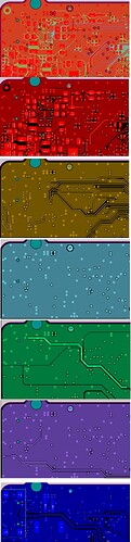

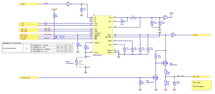

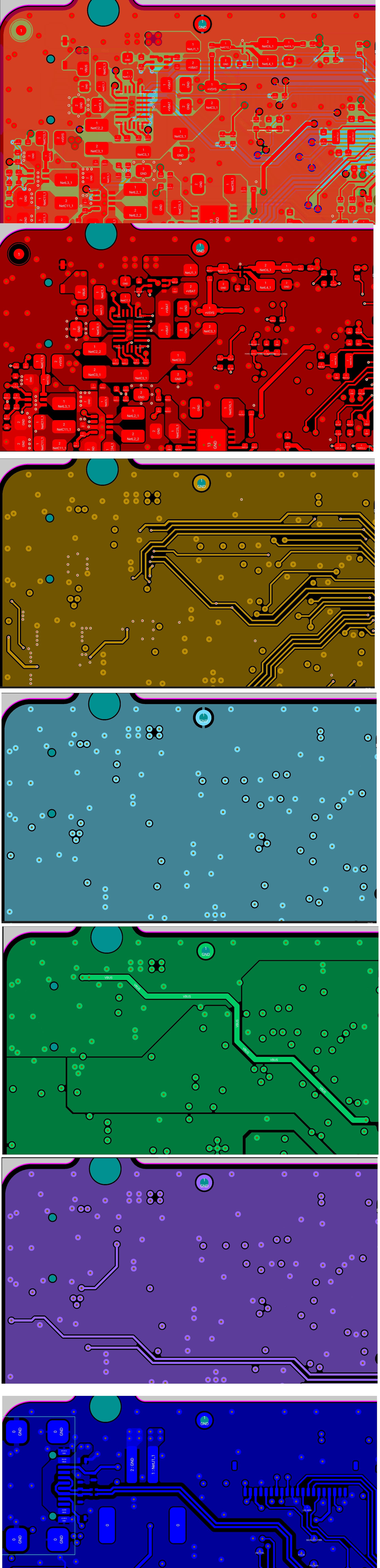

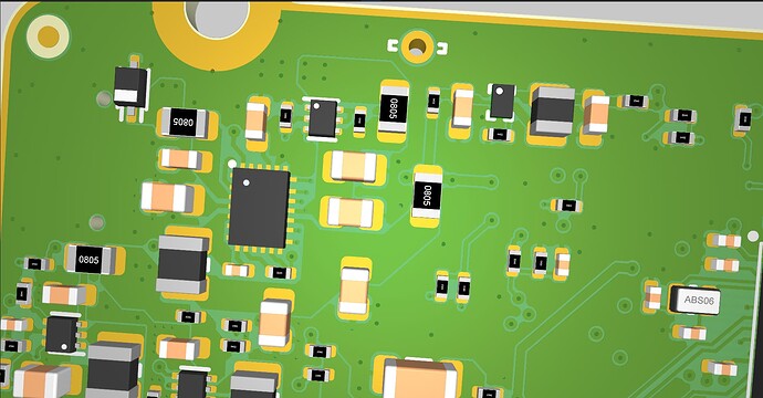

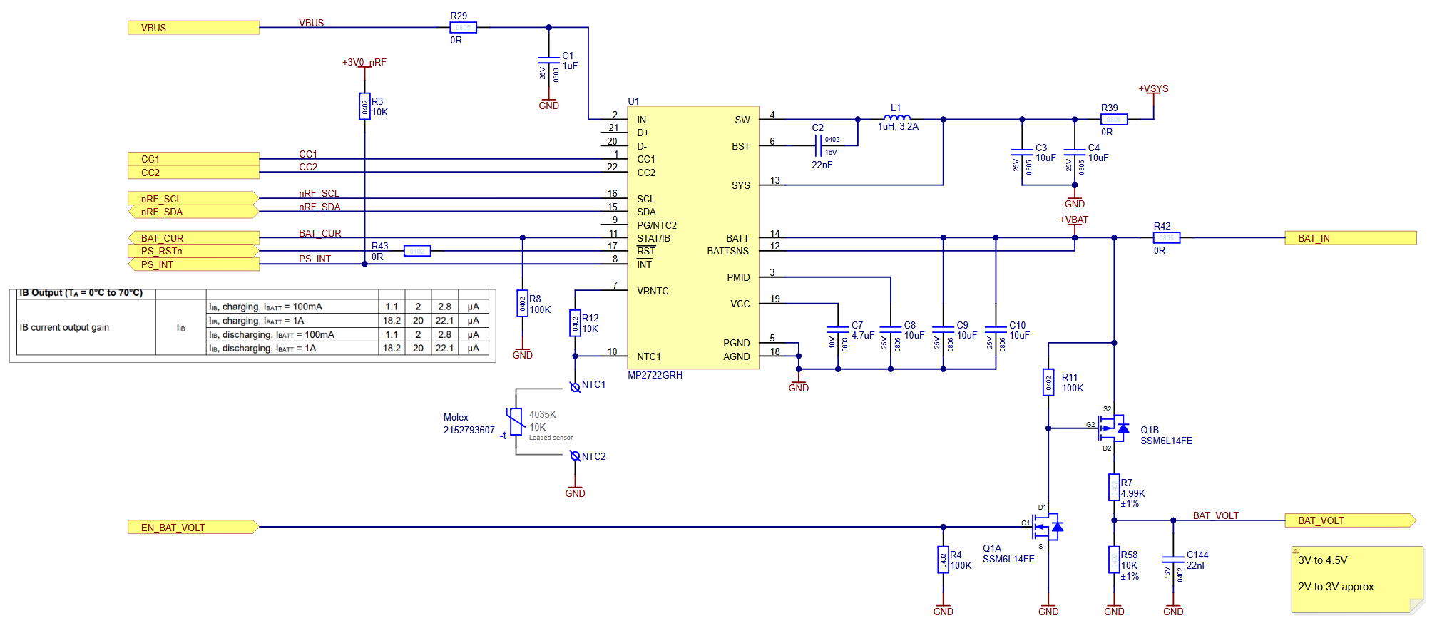

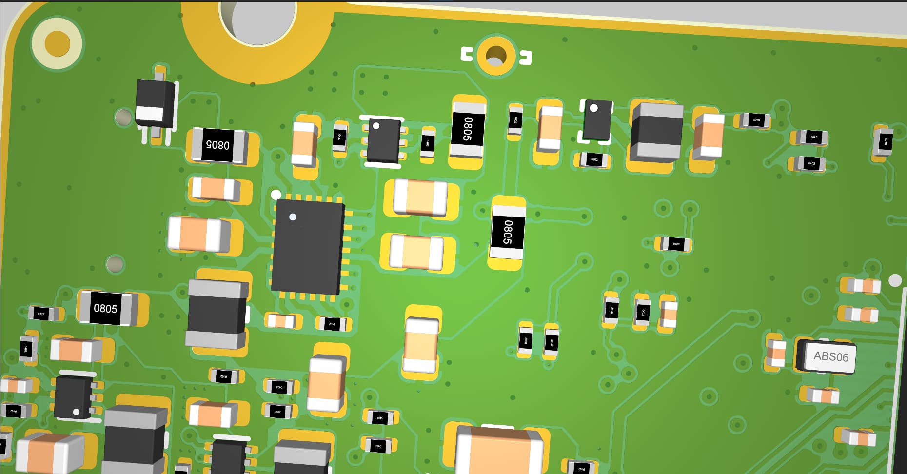

Dear,
We are developing a portable audio device powered by a 3V7 Lion battery.
We use the MP2722GRH as battery management chip.
Could you please review the attached schematic and pcb layout?
(I can send you an Altium365 link but I do not want to post this on a public forum)
Thank you very much for your time.
Kees Neervoort
Hi Kees,
Thank you for posting to the MPS Technical Forum. Please submit a ticket by filling out the MPS NOW technical support form. Thank you.
