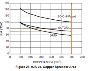

in MPQ2019 datasheet shown that the termal resistance, thita JA is 50C/W. Could MPS give us the EP space value? Due to mine heat dissipation area is not same as your. the thermal resistance will be different. Could you provide me the figure as below, that I could know the thermal impedance in my case.

Please note θJA is measured on JESD51-7, 4-layer PCB.
Exposed pad area is shown in the ‘Package Information’ section on page 16 of the datasheet.
