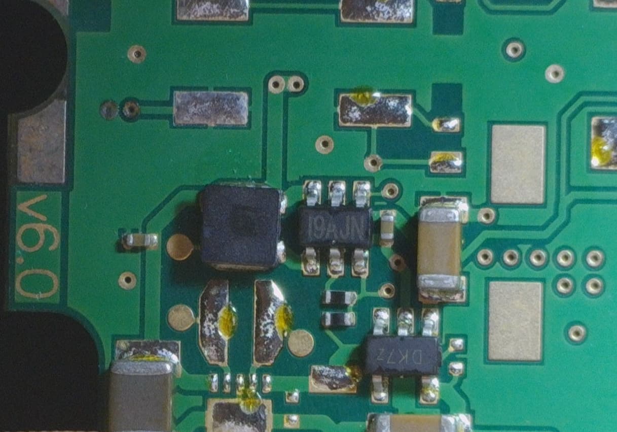

Please help identify 9AJN
Could you please help to identify marking 9AJN?
Thank you
Hello,
Looks like this is a TSOT23-6 package IC. Based on the top marking, and working with our QA team to identify this, this IC would be the following:
MP3120 | 1.2A, 1.1MHz Synchronous Boost Converter with Output Disconnect | MPS
Please verify this by measuring the input and output voltages if this IC is operational.
Best,
Krishan
Hello Krishan,
thank you very much, unfortunately the IC is not operational and I need a replacement.
But the description seems to be matching. The IC is on a laser measuring tool with 2 x 1.5V AAA batteries.
best regards
Dirk
