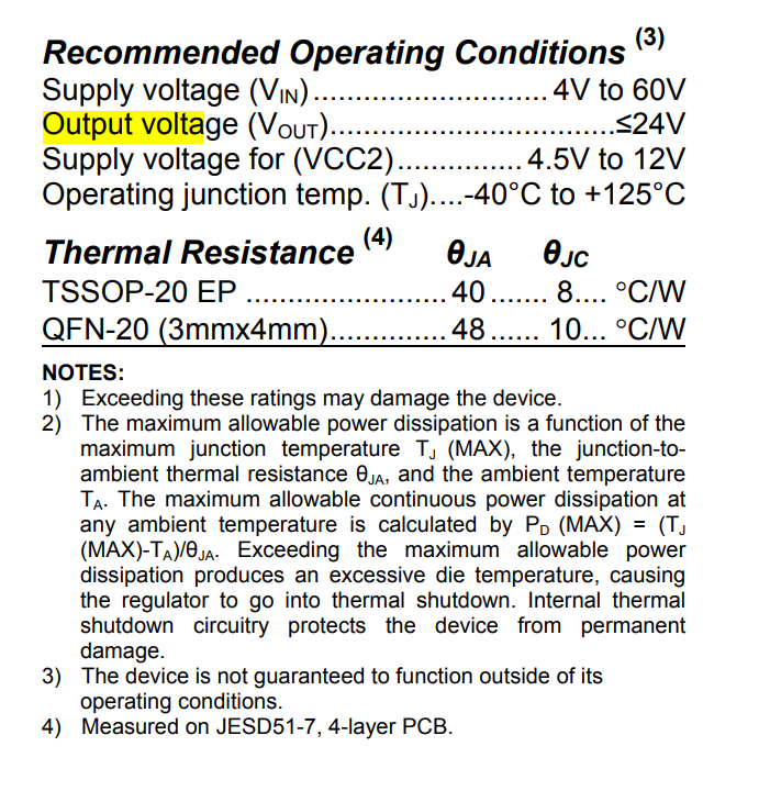

  1. In the datasheet it is mentioned that Vsense+/- Common mode threshold can not be higher than 24V, does this mean I won’t be able to regulate the output above 24V?

Hello prem.shah,
The part is recommended to operate with an output voltage below 24V and not guaranteed to function outside of this. A screenshot from the datasheet below.
digital-psg-q4-2024.pdf
As far as other options go a quick search showed MP9929
