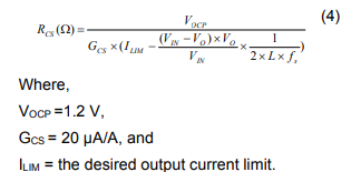

May I know the MPQ8633x OCP point is Iout + ∆1/2*iL or single Iout? Since in our design, the RCS setting 4.7k ohm will trigger 7.1A OCP even.

The current limit is what you set it to as long as it is lower than the devices 12A current limit. See I_Lim in equation below.
