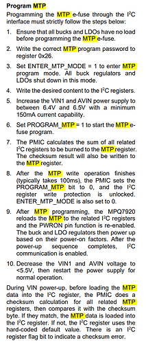

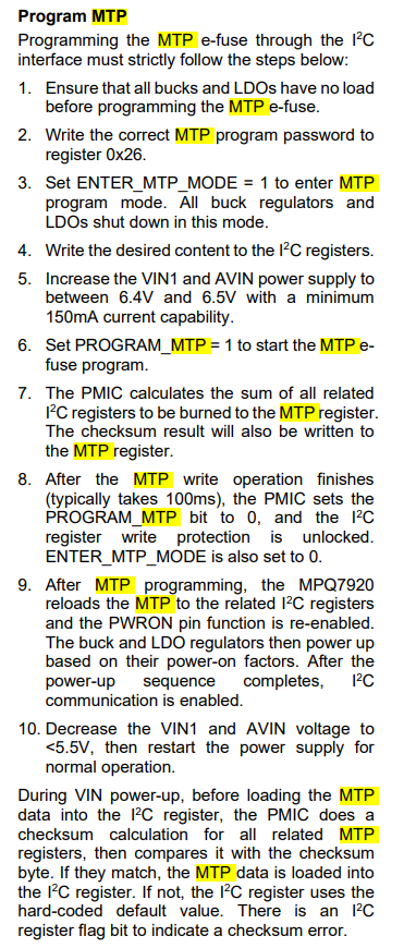

Hello parkjs,
I think this would fall under the following procedure.
If you are using the GUI, there should be a button that allows you to write to Non-volatile memory.
