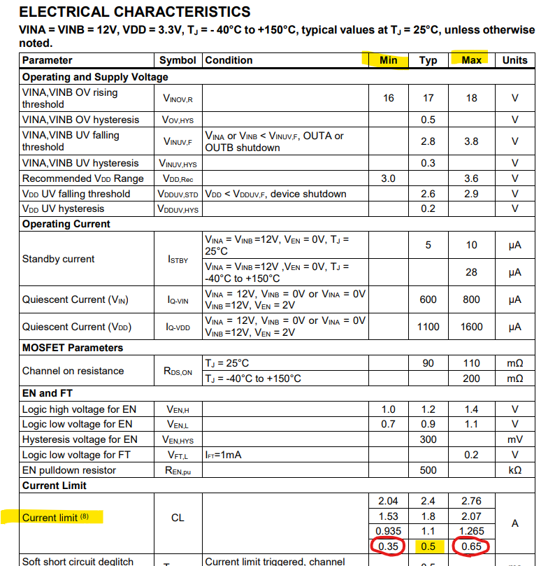

I see in the electrical characteristics part for current limit value of 0.5A → there is a MIN value of 0.35A and a MAX value of 0.65A. What is the meaning of these MIN and MAX values? Why there is such a BIG range from 0.35A to 0.65A?
Does it mean if the current limit is set to 0.5A, it can happen to be 0.35A itself? OR it can also be 0.65A also? Its very confusing and also very wierd.

The typical value is for Tj=25C. The current limit will change when the temperature changes.
