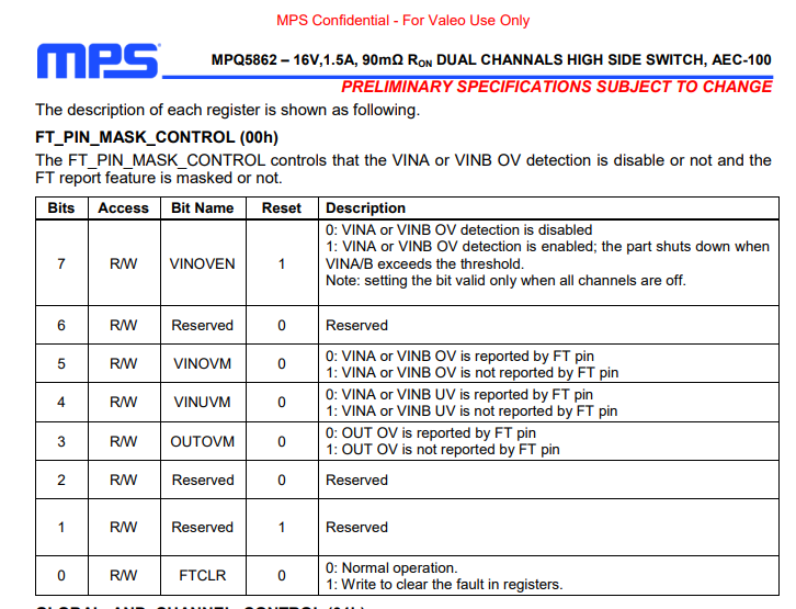

MPQ5862 : How to enable VINA Under Voltage detection? The bit VINOVEN enables Over Voltage detection. But I did not find any reference in datasheet for Under Voltage detection. IS it like the same bit VINOVEN enables Under Voltage detection also..?

The MPQ5862 does not have a dedicated register for enabling/disabling the UV detection feature.
If an UV condition where to be present on VINA, then bit[6] of 0x05 register will be asserted high. (Refer to datasheet page 22-23).
