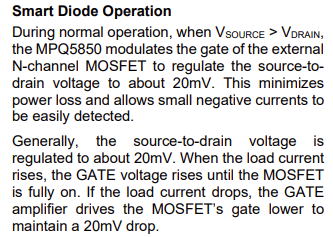

hi everyone, i was doing some tests on the mpq5850 and i wanted to make sure i get something.
Is the chip supposed to ALWAYS keep the Vsd one 20mV? or is it supposed to be kept UNDER 20mV?
Hi,
Thank you for posting to the MPS Technical Forum. For the MPQ5850, Vsd is regulated to equal 20mV. If the voltage rises or drops, the MPQ5850 will react to keep Vsd at 20mV.
