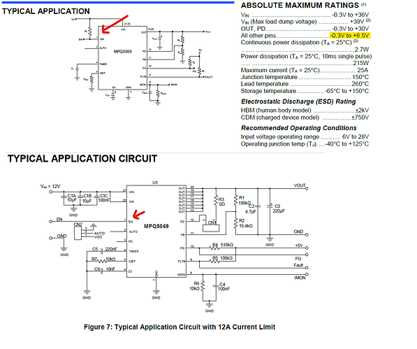

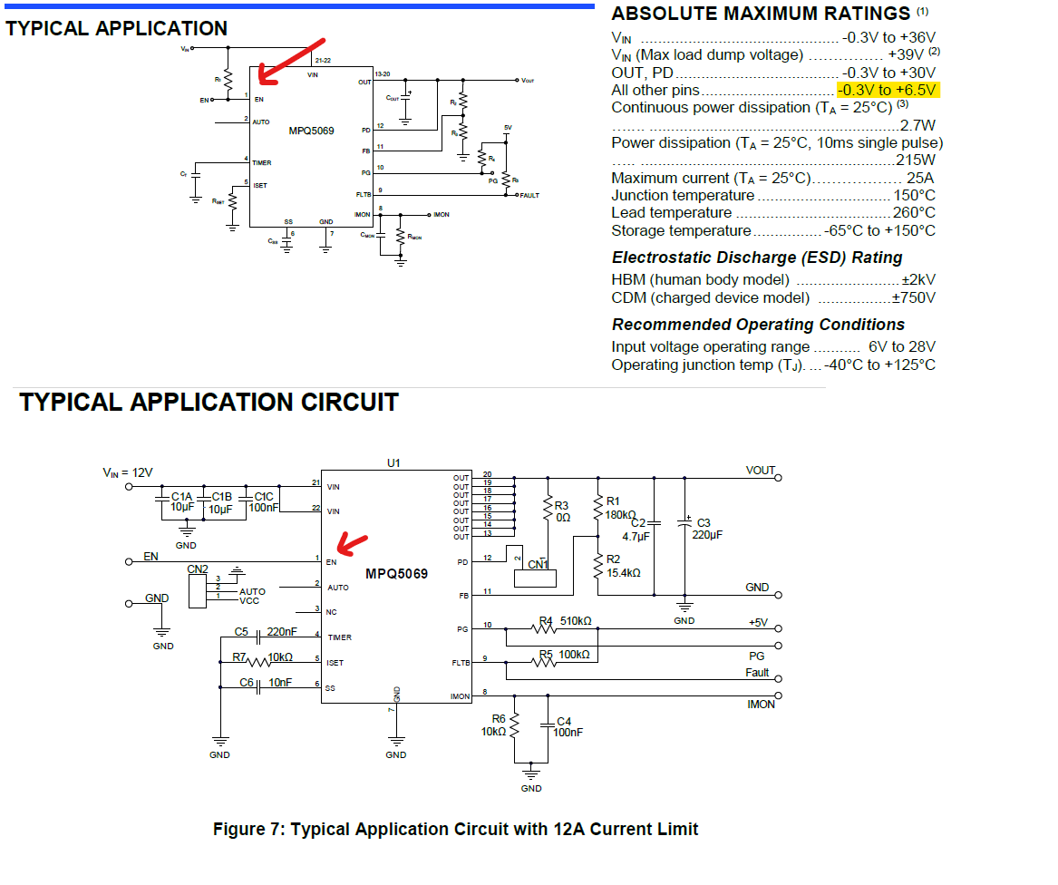

We are currently using the MPQ5069GQV-AEC1-Z part in our project and have a query regarding the EN (Enable) pin. Specifically, we are uncertain about the maximum allowable input voltage range for the EN pin, as the recommended maximum voltage is not specified in the datasheet.
After reviewing the datasheet, we have observed the following:
Could you please confirm the maximum voltage that can be safely applied to the EN pin ?
Hello purushothaman.p,
Based on the wording for all other pins I think it would be safe to operate it with a max voltage of 6.5V.
