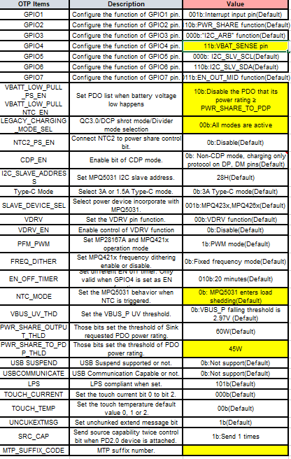

If the system is operating at high temperature, low input voltage and below 45 watts, it should not do anything. but it does not perform its function and switches to a low power profile below 45 watts. What could I have done wrong?
Hello,
I believe it makes sense that it switches to a lower power profile because of the setting for “Set PDO list when battery voltage low happens”.
Best Regards,
Yu
