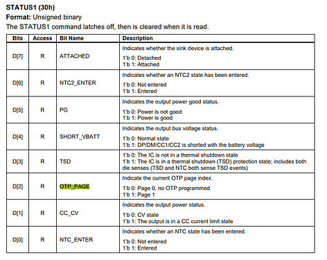

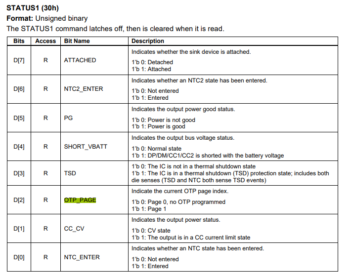

Can you give me the register values for ID1 (34h) and Status1(30h)?
Were you at least able to program it once?
0x30 (STATUS) = 0x04
0x34 (ID1) = 0x00
Hello kcooper,

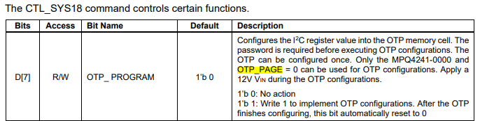

Based on the value of status1 register it seems that this has already been programmed once. I don’t think that you will be able to program nvm again. You will have to replace it with a fresh -0000 that has the OTP_PAGE bit with a value of 0.
