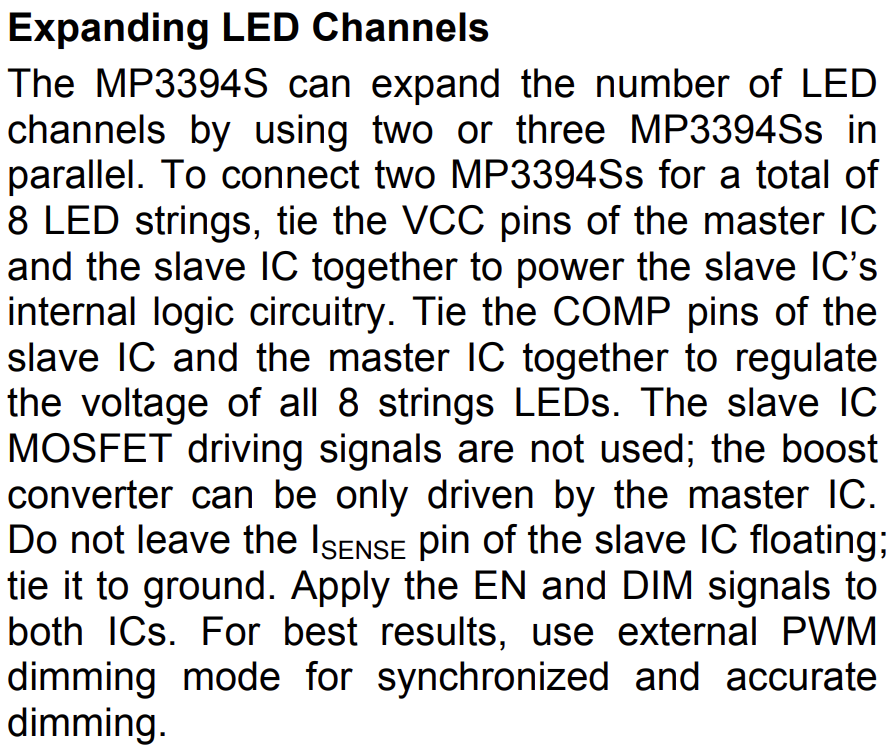

We are using the MPQ3394S to drive a LED string backlight on a product, this is working fine and is in production.
Is it possible to parallel up the channels on the MPQ3394S and if so do we need balancing resistors ?
Hi @shinichiro_moritaka ,
Are you referring to the MP3394S?
If so, you can follow these instructions from the datasheet:
