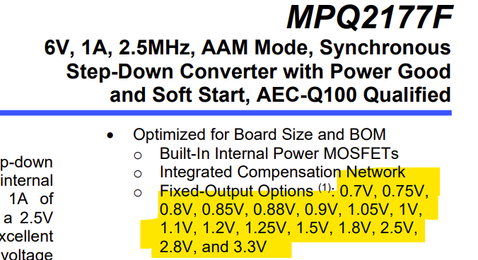

Hi Krishan,
I could see the datasheet says MPQ2177F series has all below fixed output votage version, could you pls clarify on this, Thank you.
Ah, I see, this is the MPQ2177F.
This changes some things as there are many fixed output options for this variant. The non -F version is another part entirely with only two fixed options.
You should be looking for the MPQ2177FGQHE-11-AEC1 in that case.
