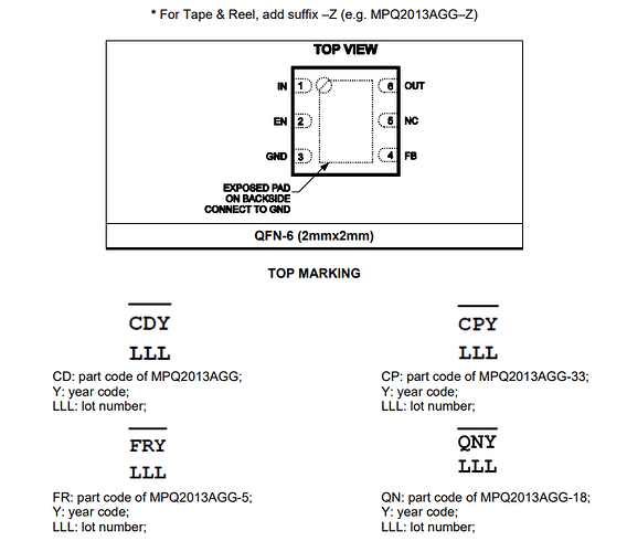

Is there a special code marking for the AEC1 qualified MPQ2013AGG?
I don’t see a specific one on the datasheet.

Hello Chester,
Can you verify that the top marking on the MPQ2013AGG is denoted with “CD" ?
Best,
Krishan

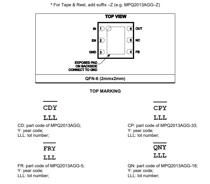

Sure Krishan
We have both the regular MPQ2013AGG and the MPQ2013AGG-AEC1.
MPQ2013AGG is marked CDM 178. MPQ2013AGG-AEC1 is marked CDP 802.
I understand that the 3rd letter is the date code, but they are both CD. Does the lot code then dictates if it’s AEC1 certified or not?
Correct, this is verified here.
Maybe you could verify the lot code with me. I can check this with colleagues from my team and get back to you on what the exact variant you have is.
