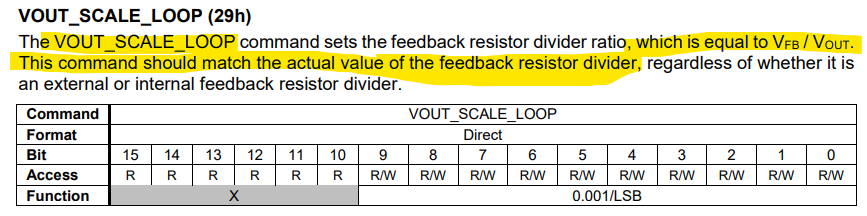

Q2. Is it possible to generate an output voltage using a resistor divider even if “Flash writing” has occurred?

For your Q1: Could you please provide a more detailed description of what kind of control you want to make with hardware?
For Q2: From the datasheet (shown below), you can change the resistors but not the ratio of the resistor after you have written to the memory.

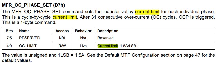

Hi,
Thanks for providing the information. By saying power output, could you please clarify if you meant output power? The module itself only determines the output voltage, and output current is set by the load itself as long as it doesn’t reach the current limit. You can only set the current limit by the PMBus.
