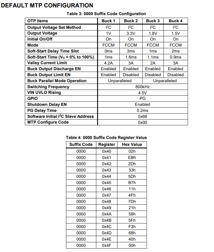

  1. Yes, you can parallel two of the channels for a 6V/4A.
  2. I would recommend using I2C as the different channels have different start up sequences you will need to program, including whether or not specific channels are paralleled. You can check the different configurations starting on page 42.
  3. Default configuration on startup is as follows:
