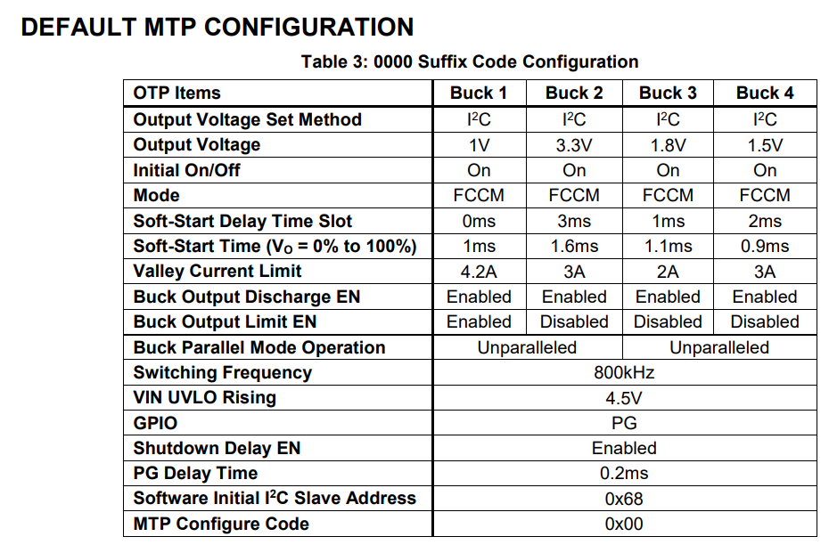

On my board I need 1.1V/1.2V/1.8V/2.5V and the default voltage are 1V/1.5V/1.8V/3.3V.
I don’t find in the documentation if the voltage output are activated by default.

I see you are currently using a 0000 suffix code for MPM54304. In this case, by default they are set, if you refer the page 42 of the datasheet.
Yes your assumption is correct. For adjusting the values for the output voltage you want, you will be needing a Virtual Bench software for setting the I2C registers values & the USB to I2C dongle.
For MPM54322, the output voltage settings depends on the MODE pin resistor selection and its register configuration for the mode that you need to use. You will be needing I2C dongle for this as mentioned above.
