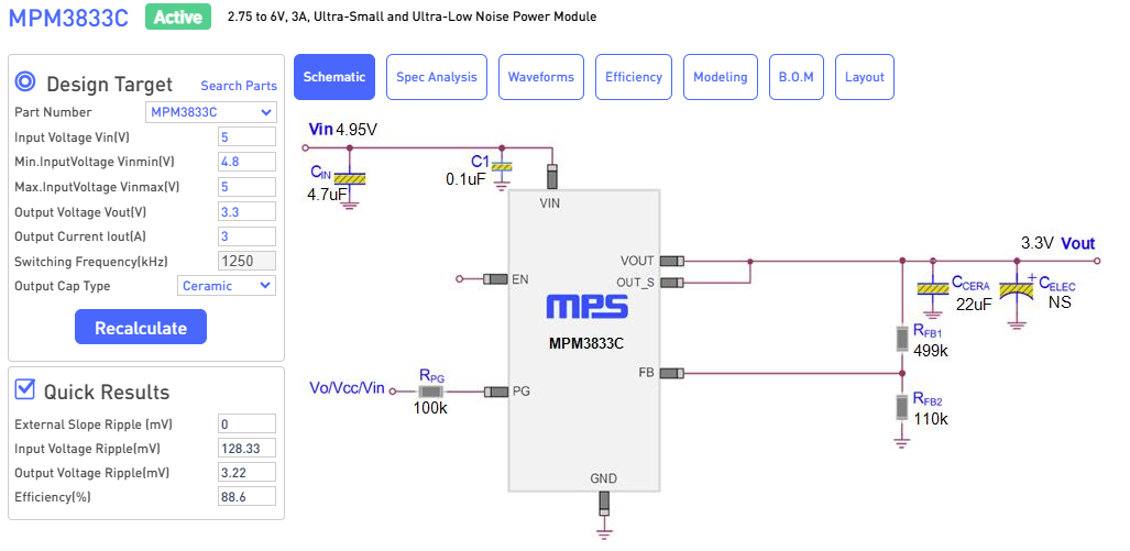

I would like to use MPM3833C to converter 5V to 3.3V. I have used the DC DC designer online to check how much the 5V input swing range can be allowed. The Min. input voltage is 5V, otherwise a notice come up- Vout is too large due to the minimum off time limitation under this switch frequency.
Will the MPM3833C not convert 4.8V to 3.3V properly?

The DCDC Designer tool has some headroom for voltage drop on the inductor and FET. So although the calculated duty cycle is ~68%, the actual maybe higher and not supported.
Try checking out the MPM3834C.

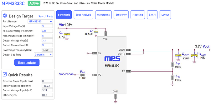

I have selected confidently the MPM3833C but now I’am doubting about that product. I’am reading contraditoring thing between datasheet and DCDC designer, more precisely on Switching frequency which is 1150KHz on datasheet, and 1250Khz on my DC DC designer tools.

The switching frequency should be 1150 kHz as specified in the datasheet. You can check the sizing of any external discrete components with your module using the sizing equations as specified in the MPM3833C datasheet to verify the sizing of the parts as recommended by the DC/DC designer.
The output resistors you have should be fine. Double check the sizing of input and output capacitors as they are functions of the switching frequency.
