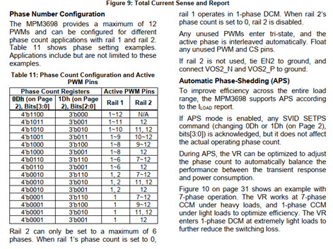

You should be able to set single or dual output through 0Dh,b[3:0] page2 and 1Dh,b[2:0] page2.
Set 0Dh,b[3:0] page2=4’b0010; 1Dh,b[2:0] page2=3’b001 is for dual output (80A+40A).
Set 0Dh,b[3:0] page2=4’b0011; 1Dh,b[2:0] page2=3’b000 is for single output (120A) .
Refer to registers 0Dh and 1Dh. Let us know if there are any more questions here or if clarification is needed.
Further reference from the datasheet.
