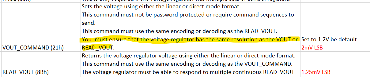

Intel has the following requirement of a power regualtor:
This is found in tabel 5 of https://cdrdv2-public.intel.com/757319/an974-757318-757319.pdf
If I am interpreting the datasheet for the MPM3695GBH-100 correctly it seems that it will not be sufficient to work for this Agilex part because of a mismatch in resolutions
Am I missing something?

Hi Grant,
Apologies for the delayed response.
If SmartVID is required, MPM3695-100 can be used with an external MCU for translating the resolution to match. However, the MPM3698 is a module that supports Intel FPGA SmartVID. For further support/questions, please reach out to MPS NOW Remote Support - Support.
