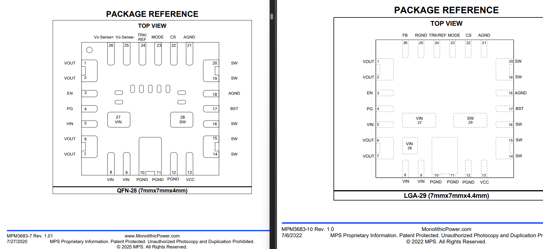

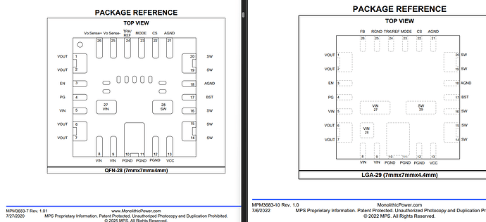

The MPM3683-7 is not recommended for new designs. I would first suggest switching over to the following part as it has the same voltage capabilities and a higher continuous current threshold of 10A.
Package pinout and dimensions are also nearly identical:
