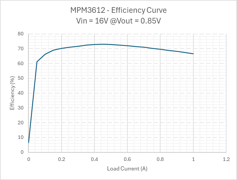

Would like to check is there any efficiency plot on MPM3612 for low voltage output with high voltage input.
Target on 16Vin to 0.85Vout.

Hi Ping,
Apologies for the delay in getting back, as MPS had a thanksgiving shutdown period for the last week.
I can work on collecting the data on our EVB for you and will get back to you.
May I know what kind of application is this, is it for any FPGA rail?
