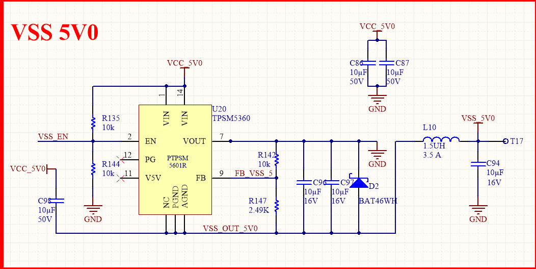

need to know something specific on MPM3610AGQV-Z on this part, does this part with any config can give a negative output, now we are using TI part for that purpose, which can give negative out with some configs, Here attaching what we used, like this did we can config this MPM3610AGQV-Z if possible ?

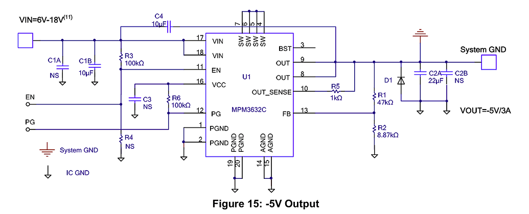

The MPM3610 does not specify a negative output configuration. However, the MPM3632C does have this configuration. Could this work for your application?
