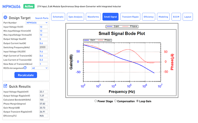

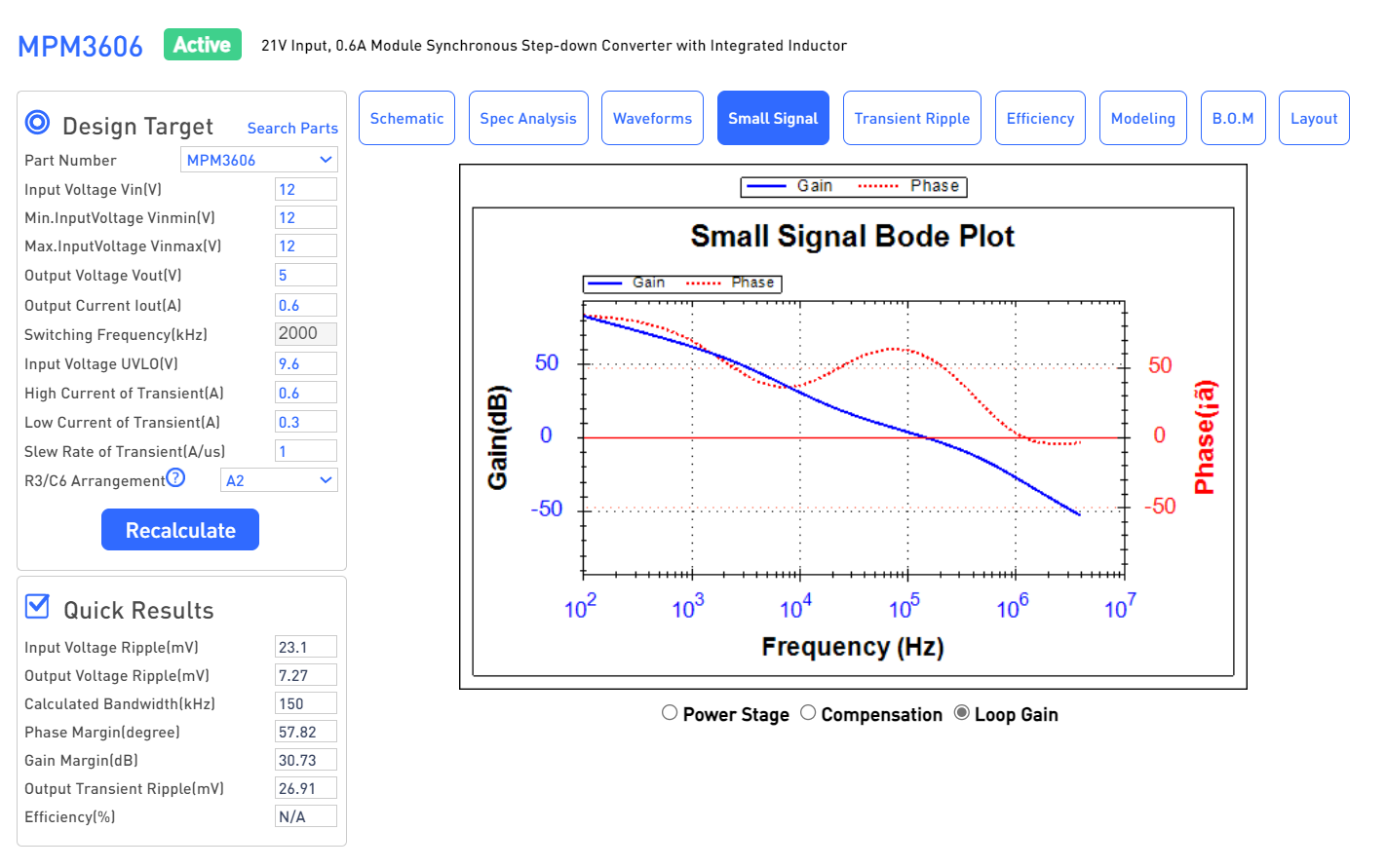

When changing the output voltage from 3V to 5V of the on line simulator for a MPM3606, phase margin and efficiency are non available.
Is there a way to get these 2 missing curves/values?
What is the input voltage that you are using? Below is the MPM3606 with the phase margin

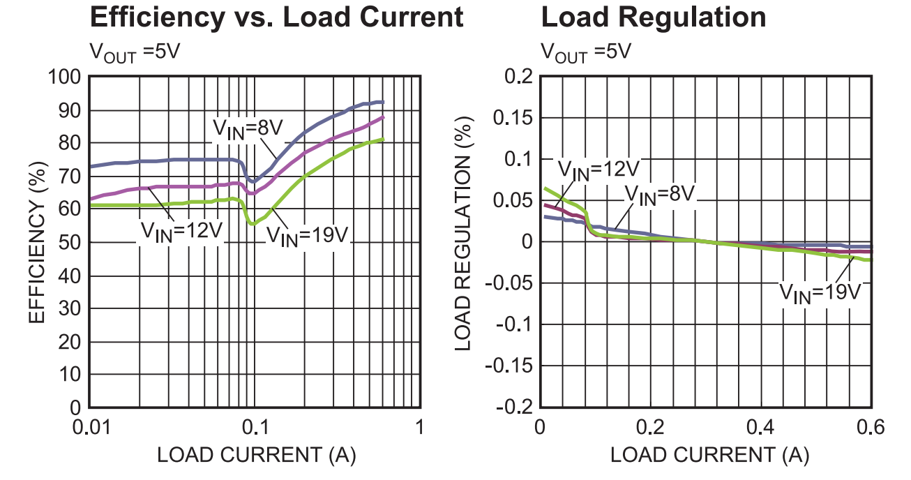

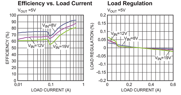

However, the efficiency in this case using the DC / DC designer does not show up as you said. So, all I am able to provide at this time is the following efficiency curves of the MPM3606 where
Vout = 5V. They include Vin = 8V, 12V, and 19V. If your Vin is not 12V, then hopefully the following efficiency curves can be used for extrapolation for your estimated purposes. See the MPM3606 datasheet for other conditions and match them with your own.
