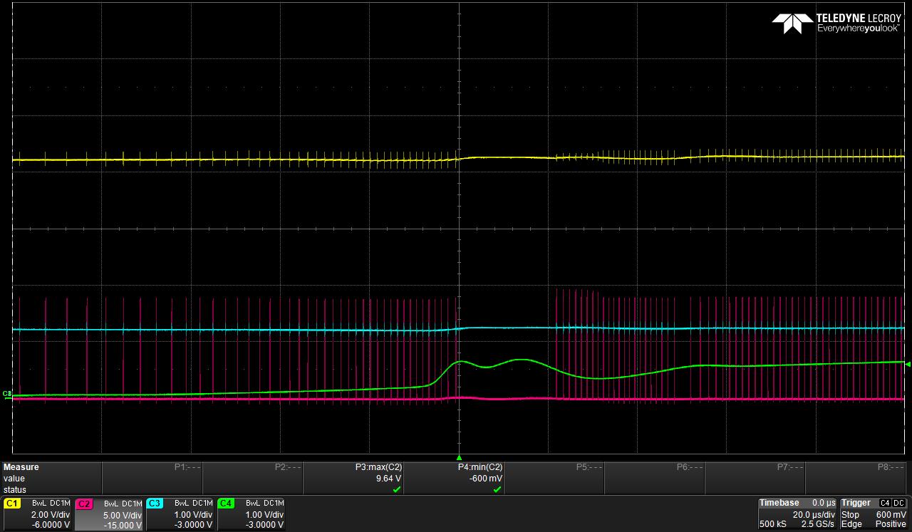

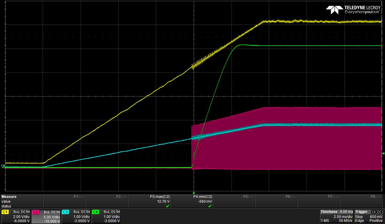

It can be seen that during the startup, the output voltage drops and gate stop.
Could you let us know what your input conditions are? Is it possible the input current limit is too low? The first picture show shows your input of 12V. However, the second shows it barely above 8V. The device also looks to be operating in hiccup mode which is triggered by UV or OCP. I don’t think it is OCP because this is an 8A continuous device.
