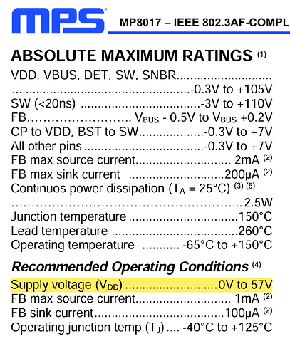

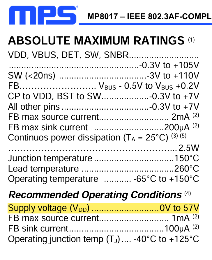

Hello,
Theoretically yes, there should be no issue with this. So long as you are within the recommended VDD range as highlighted below:
