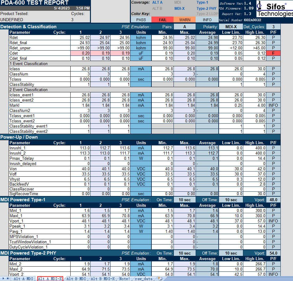

We designed our own POE circuit according to the MP8017 EVB, but when using the PDA-600 for compatibility testing, the Rdet and Cdet fail items appeared. Any suggestions?
The test results of the two ALT B mode are the same with those of the ALT A MDI-X.
