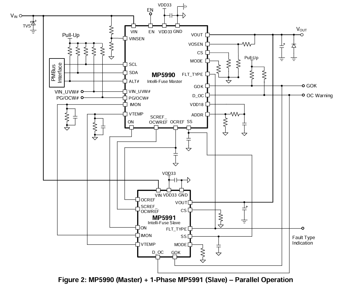

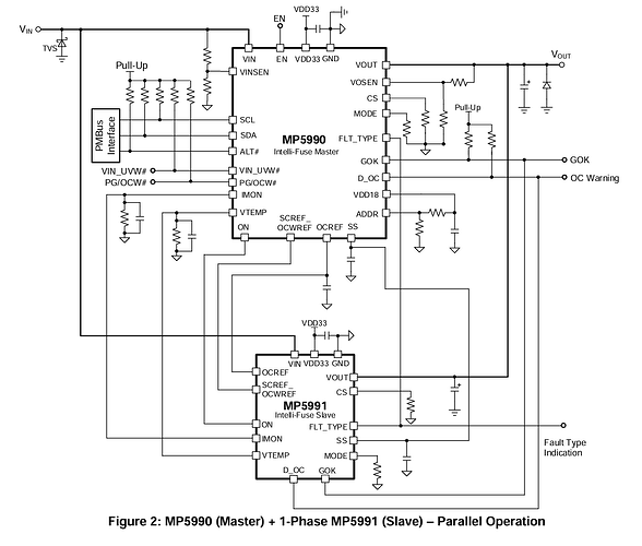

According to the typical application, the Vin should be connected to the same source. As for connecting the outputs together, please connect them in the following manner as shown below:
There is a more detailed reference for the schematic shown with the following evaluation board: EV5990-5991-V-5PHASE-00A | 16V, 50A, Hot-Swap Intelli-Fuse Solution Evaluation Board | MPS
Let me know if there are any specific questions with this configuration.
