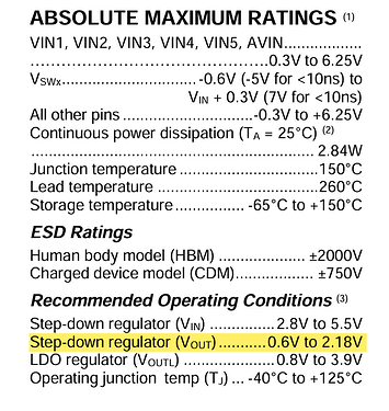

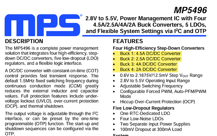

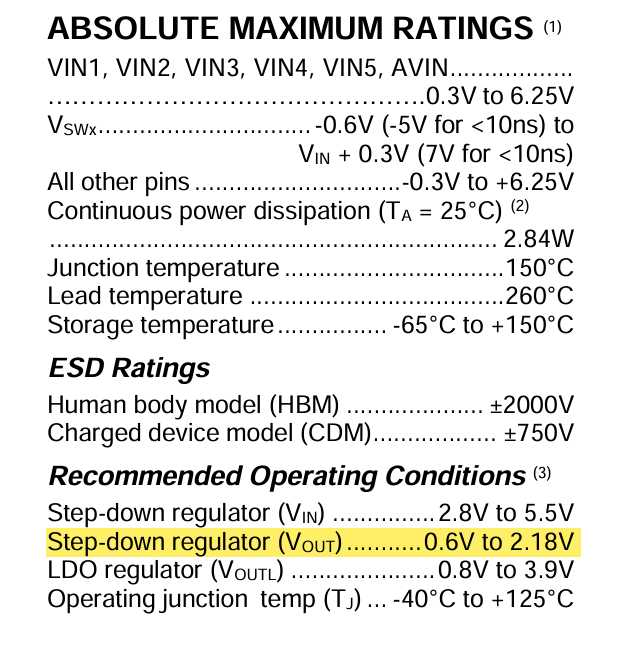

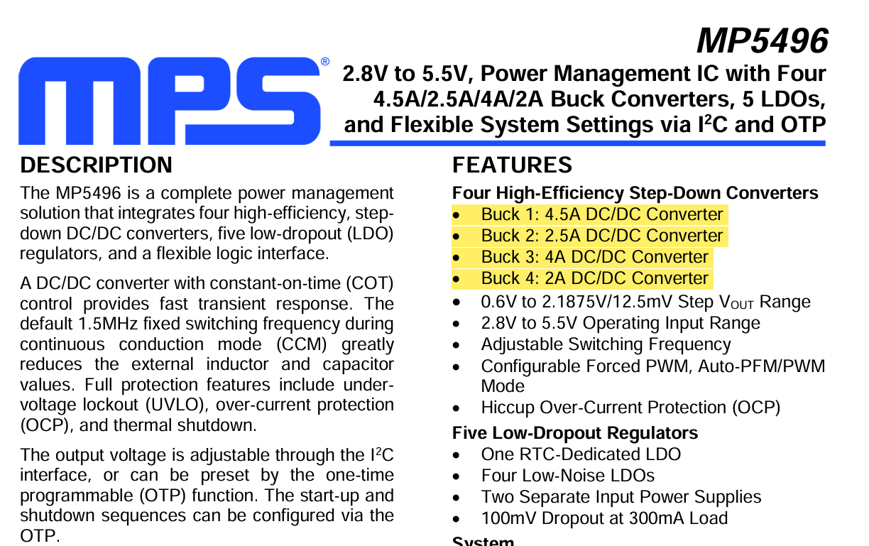

Hello Sooraj,
From a high-level glance, this 4 channel PMIC seems very capable, satisfying all current levels you have shown:
The full output voltage range of each of the output channels ranges from 0.6V to 2.18V as shown in the recommended operating conditions:
The MP5496 seems like a very capable choice for this application.
