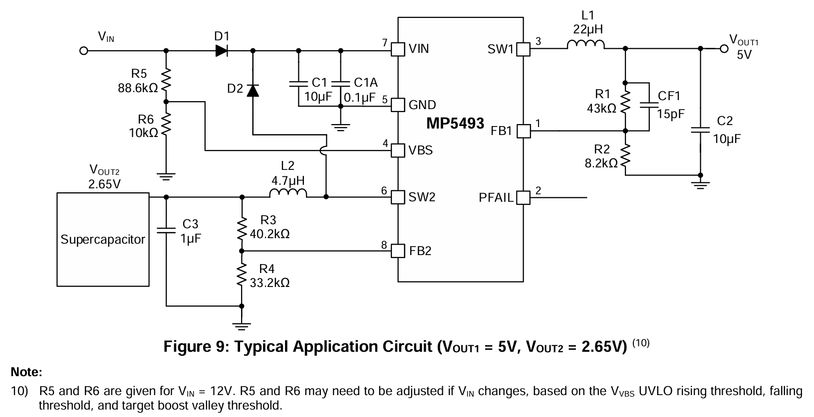

  1. The MP5493 should be capable of 5Vout with a load current of 0.5A. We have a typical application circuit that can be shown here:

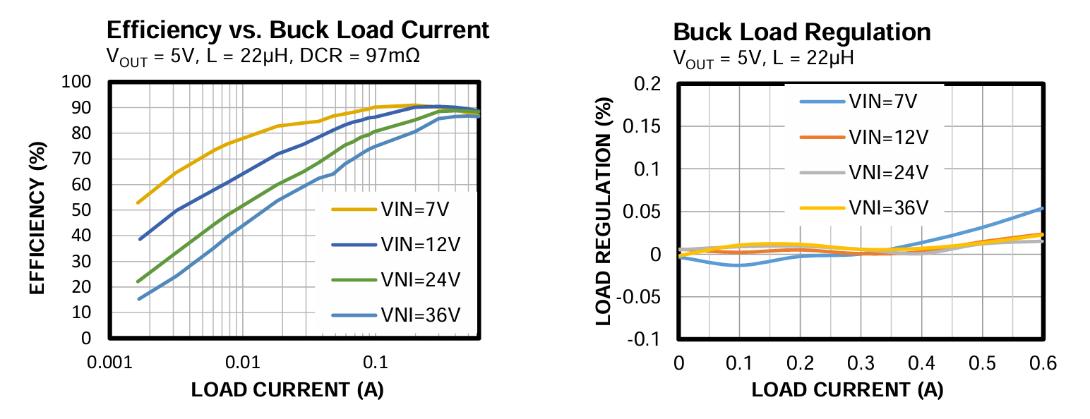

  2. For a 5V output, the maximum current achievable at the output would be 0.6A. Please see the following efficiency and load regulation curves:

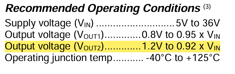

  3. According to the recommended operating conditions as outlined in the datasheet, the minimum regulated voltage for the supercapacitor output here would be 1.2V as shown:
    Is it possible for you to adjust your minimum and maximum ranges of your supercapacitor?
