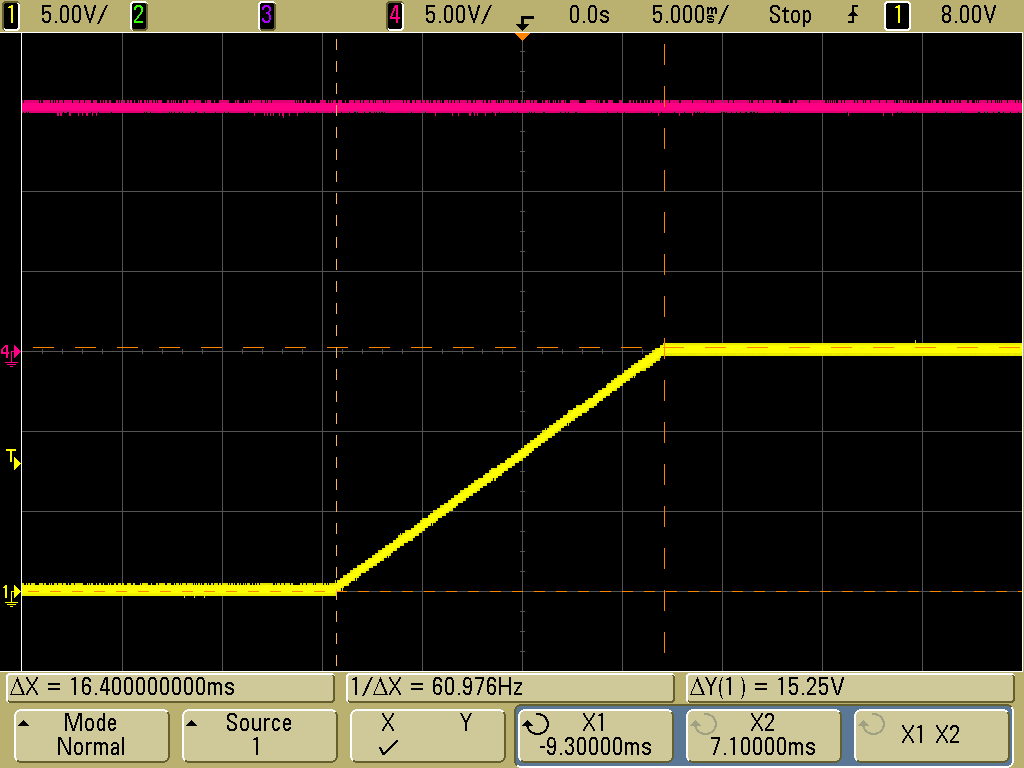

According to the datasheet, the output voltage ramp rate is controlled by the dV/dt pin using an external capacitor. When the dV/dt pin is left unconnected, the default ramp rate is specified as approximately 0.9 V/ms.
I have verified this behavior by measurement, and under normal startup conditions the ramp rate indeed corresponds to this value.

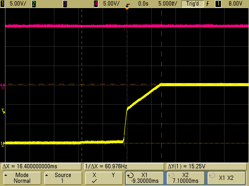

In some cases, after the output short circuit is removed and the device restarts, the output voltage ramps up significantly faster than the expected 0.9 V/ms default. This faster ramp does not occur consistently, but only occasionally, under otherwise identical conditions.
Key points:
dV/dt pin is left unconnected (no external capacitor)
Normal startup ramp rate matches the datasheet (~0.9 V/ms)
After short-circuit recovery, the ramp rate is sometimes noticeably faster
Supply voltage, load, and ambient conditions are unchanged

Correct behavior: Red - input voltage, yellow - output voltage
Incorrect behavior
