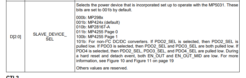

I wonder if we can use MP5031 without configuring its registers with I2C ? Can we set the charging voltage/current with putting external resistors ? And if we want to use MP5031 with MP4245 and connect the I2C line between them, should we do some IC register programming before that or they just communicate with each other without any preliminary configuration ?
