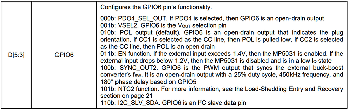

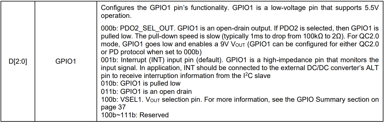

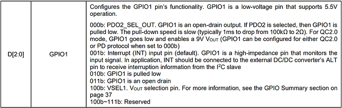

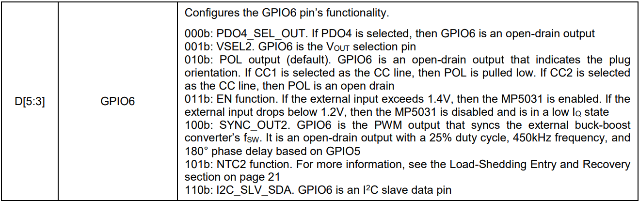

I configured the CTL3 and CTL4 as per the datasheet.
CTL3 D[2:0]: 100b
CTL4 D[5:3]: 001b
Other register values remains unchanged, but still getting 5V constant output.
