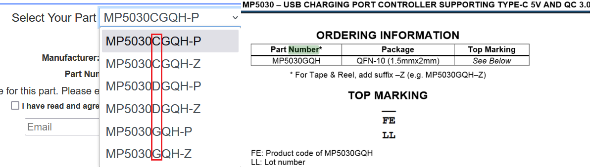

Hi,
There is no information between the differences in orderable part numbers, what do the differences mean? Also we have found that the current limit accuracy has improved in a new batch when compared to a batch from 2+ years ago, in the old batch an overcurrent event would occur between 1.1A to 1.3A when it was set to 0.9A however the new chips seem to be around 1A trip limit when a 5.1k pulldown is used.
