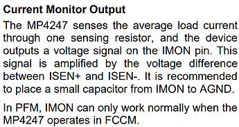

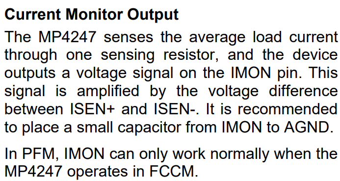

Instead, this is what the MP4247 datasheet (page 23) has to say about reading the current through the IMON pin:
From this, the Voltage from IMON and the sensing resistor should yield the exact average current running through ISEN+ and ISEN- in this case. Hopefully this helps.
