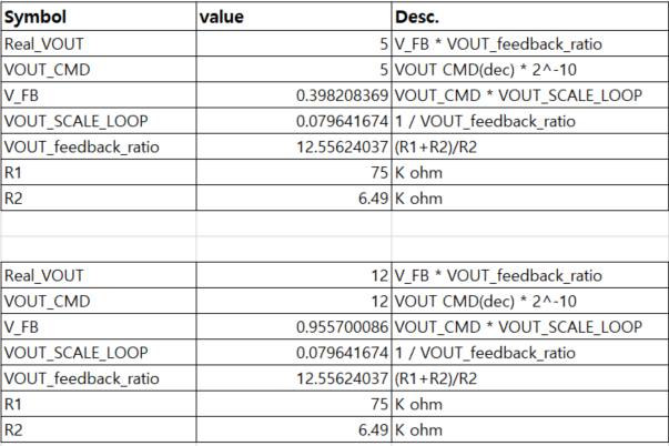

The reason for this question is that I initially thought it was possible, but it seems that V_FB, Scale_loop, and feedback_ratio are interrelated and the output is ultimately determined by the VOUT_COMMAND value. Am I understanding this correctly?

Hello,
Yes, your understanding is correct, the output voltage is set with a combination you had outlined. This is due to the application for this part being optimized for use with a power delivery controller. What is your end application? Are you only looking for Buck-Boost topologies?
