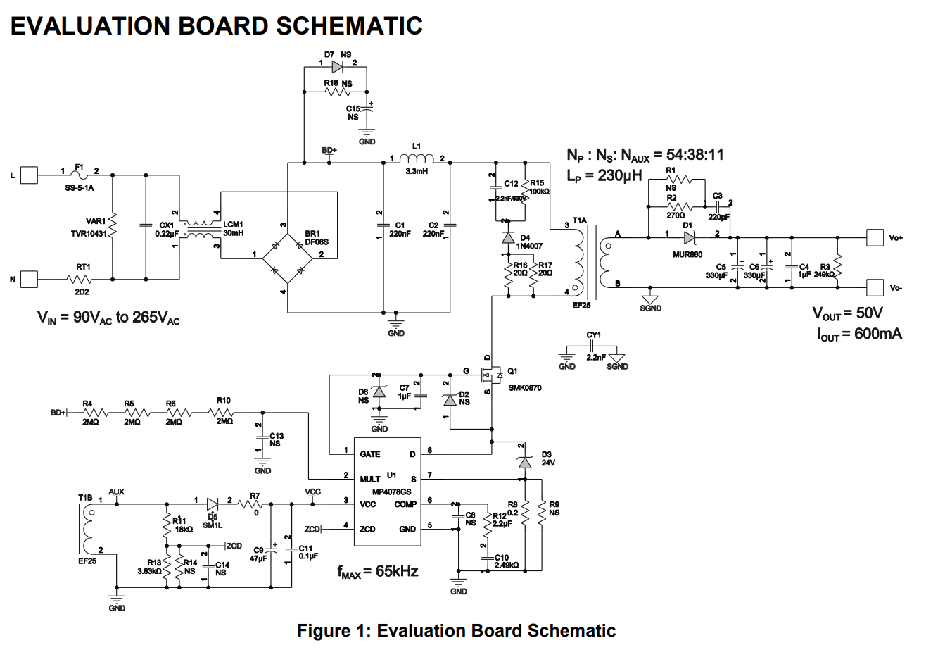

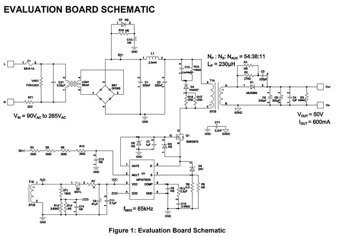

We also offer an evaluation board that you could use in place of a simulation:
EV4078-S-00A | 90VAC/60Hz to 265VAC/50Hz, 50V/600mA, 30W Single-Stage Flyback Converter with PFC Evalutation Board | MPS
You can swap components relative to your application or see if the current implementation here fits what you are looking for from this part. See the following schematic from the EVB:
