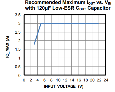

Taking a look at this graph from the MP28167 datasheet, looks like the load current is limited at lower input voltages and doesn’t reach 2.5A a little past 4Vin, which aligns with the behavior that you have described, so looks like your requirement of 2.5A where Vin = 3.3V - 4V is not possible with this IC.

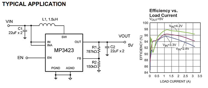

Consider the following IC for your application and read through the datasheet for expected characteristics:
