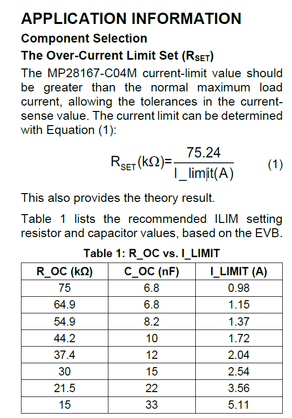

In datasheet, mentioned 21.5k resistor is used for using register to adjust the limit.
What’s the initial setting before change?
If I don’t need to change it by I2C, what kind of resistor value should I use?

Hi Liping,
Please see the figure below:
It is on the datasheet 16 page. Please let me know if you have any other questions. Thanks!
Best,
Fox
Thanks, this table is in MP28167 (fix 5V) datasheet, but it’s not in MP28167-A (with FB pin) datasheet.
So you assume it’s the same, right?
